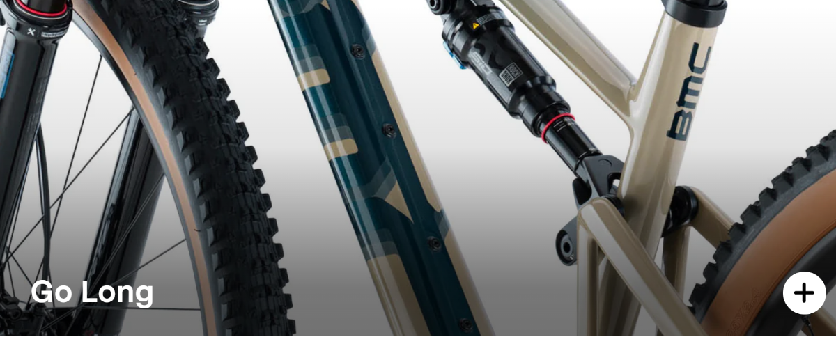

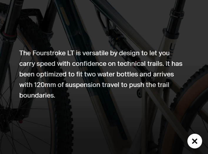

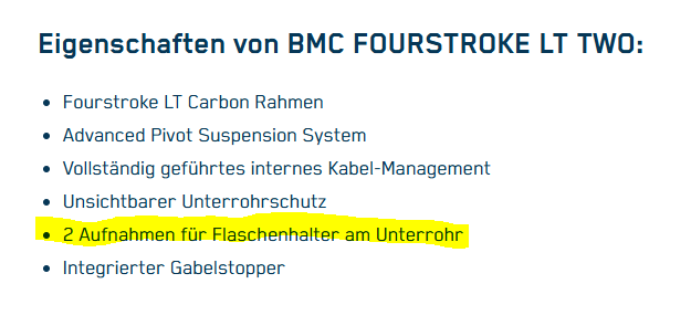

wr81 Napisano 26 Lutego Napisano 26 Lutego @KSikorski do listy 2 bidonowej: BMC Fourstroke https://www.bike24.de/p1777341.html 1 Cytuj

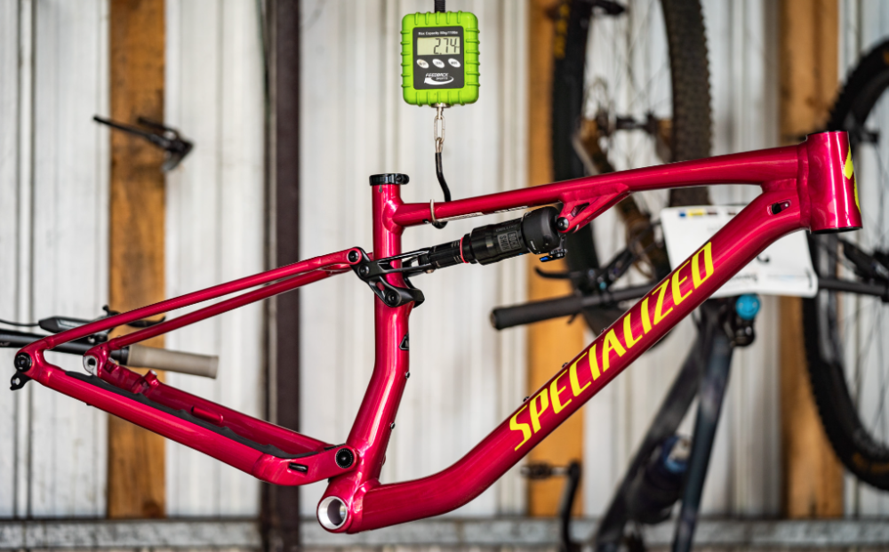

KSikorski Napisano 27 Lutego Napisano 27 Lutego To ja dorzucę jeszcze znalezione w sieci masy ram... Cytat Where things get a little easier to compare is frame weight. Shown below are the claimed weights from each manufacturer, which is for a frame with the rear shock and basic hardware; Specialized S-Works Epic World Cup – 1,712g Cervelo ZFS-5 – 1,718g Giant Anthem Advanced Pro – 1,735g Specialized S-Works Epic 8 – 1,795g Orbea Oiz OMX – 1,798g Scott Spark HMX SL – 1,870g Canyon Lux World Cup CFR – 1,894g Cannondale Scalpel Hi-Mod – 1,910g Santa Cruz Blur 4 – 1,933g Trek Supercaliber SLR – 1,950g Specialized Epic EVO – 1,965g Merida Ninety-Six RC – 2,064g Pivot Mach 4 SL – 2,087g Canyon Lux Trail CFR – 2,104g Specialized Epic 8 EVO – 2,210g Trek Top Fuel – 2,600g As for confirmed weights, I have had the opportunity to strip a couple of test bikes down to see how close they were to the manufacturers claims. Listed below are the weights for the frame, shock and key hardware, but no thru-axle; Giant Anthem – 1,807g (w/Fox Float DPS) Canyon Lux World Cup CFR – 1,941g (w/Fox Float DPS) Specialized S-Works Epic 8 – 1,950g (w/RockShox SIDLuxe) Trek Top Fuel – 2,600g (w/RockShox Deluxe) Oraz chisel: Cytat 2 Cytuj

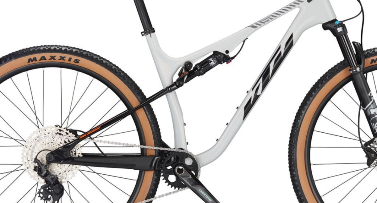

wr81 Napisano 7 Marca Napisano 7 Marca @KSikorski Do listy 2 bidonowców : KTM Scarp (a i możę by 3 próbować wcisnąć ;)) Cytuj
