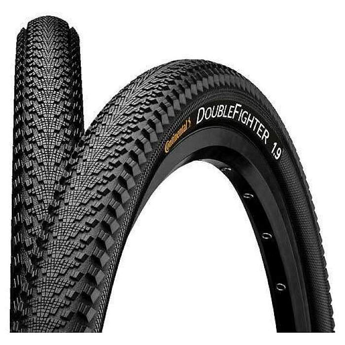

Sobek82 Napisano 8 Marca 2021 Napisano 8 Marca 2021 https://www.centrumrowerowe.pl/opona-continental-double-fighter-iii-pd3446/?v_Id=97601
