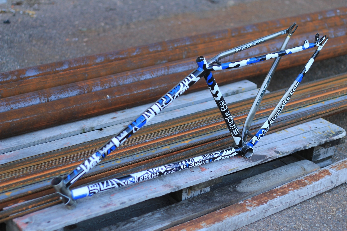

29" singlowo, waga 2250
s_singlebe_ocelove_ramy_na_zakazku_29er_
albo taki tam haczyk, no no...
singlebe_pulse_29er_singlespeed_ocel_ste
